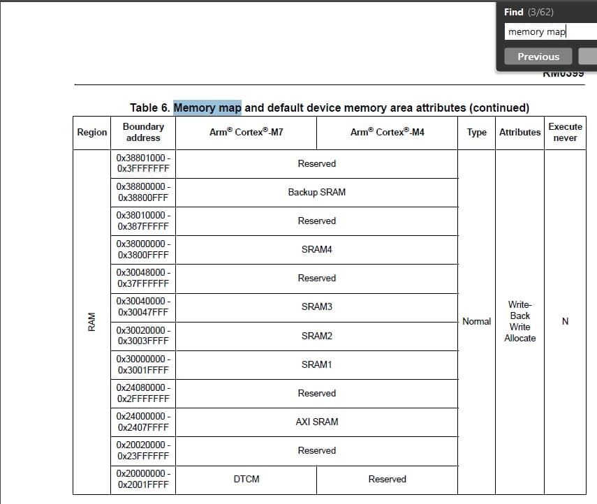

Here is also the memory mapped file of my MCU:
I would really appreciate if you inform me What is my mistake ?

AXIMRAM (xrw) : ORIGIN = 0x24000000, LENGTH = 512K
SRAM123 (xrw) : ORIGIN = 0x30000000, LENGTH = 288K

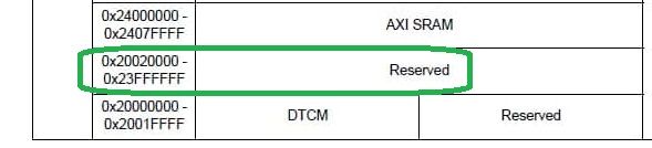

Doesn't it say 0x20020000 thru 0x23FFFFFF is reserved? DTCM being 128 KB
There are other memories which should have their clocks enabled.

I think the problem I have is that I only access 128KB of Ram using M7 Core (based on what I see in Build analyzer and in STM32H755ZITX_FLASH.ld file). when I define global variables (three float arrays each of which has 15000 elements) I get RAM overflow error and when I define them In main ram overflow error disappears but after storing 12450 samples in RAM the program crashes and get the hard fault error. If I find a way so that I understand how can I use other bigger blocks of SRAM the problem will be solved. any idea :)?

Thank you Tesla. that was a nice reply! I changed the FLASH.ld file as you explained , which is presented as follows:

something that I forgot to take it into consideration was correct calculation of end of the RAM in my case it is : _estack = 0x24080000; /* end of RAM */
previously, it was _estack = 0x20020000; this parameter should be changed in FLASH.ld and also RAM.ld file of the MCU. Now, everything works correctly and I could store the whole data into 512KB RAM which can be accessed by M7 core.
