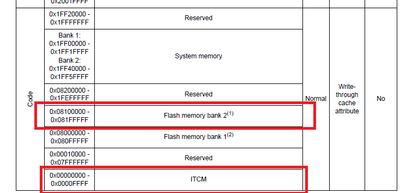

2025-10-02 2:35 AM
The phenomena could be due to a CM7 speculative access to the System memory region.
So try to disable the access to the System memory region using this MPU config during the program/erase process:

If it doesn't work try to disable all the instruction access to the code region except for BANK2/ITCM (if you are using it) using the MPU:
