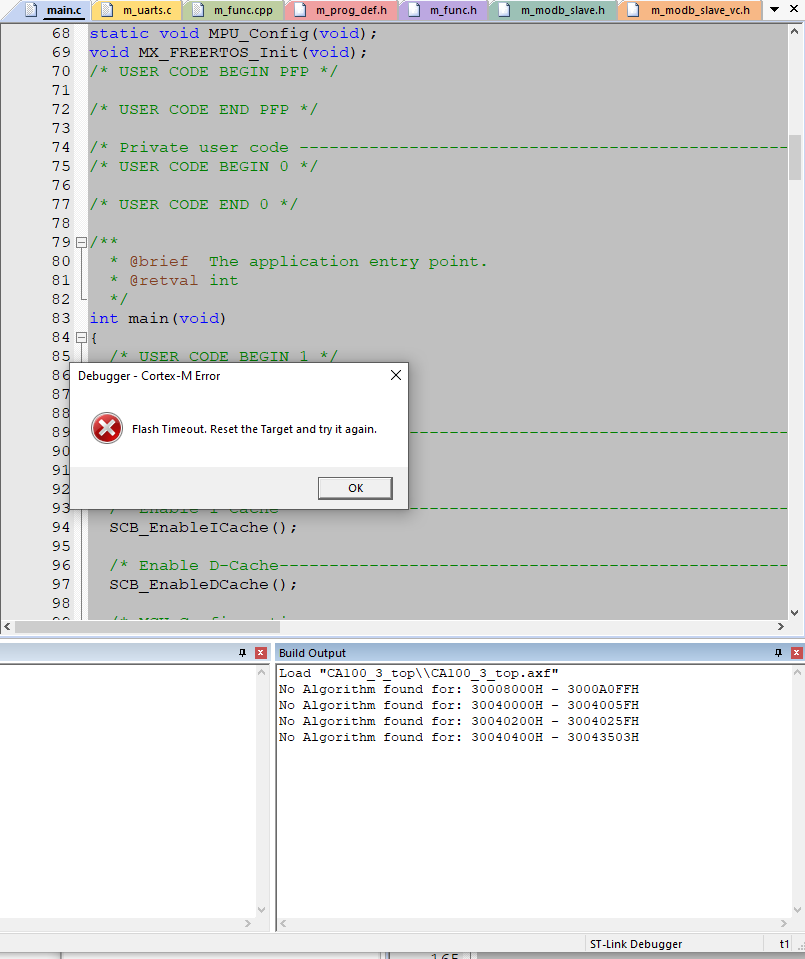

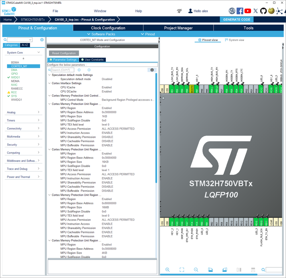

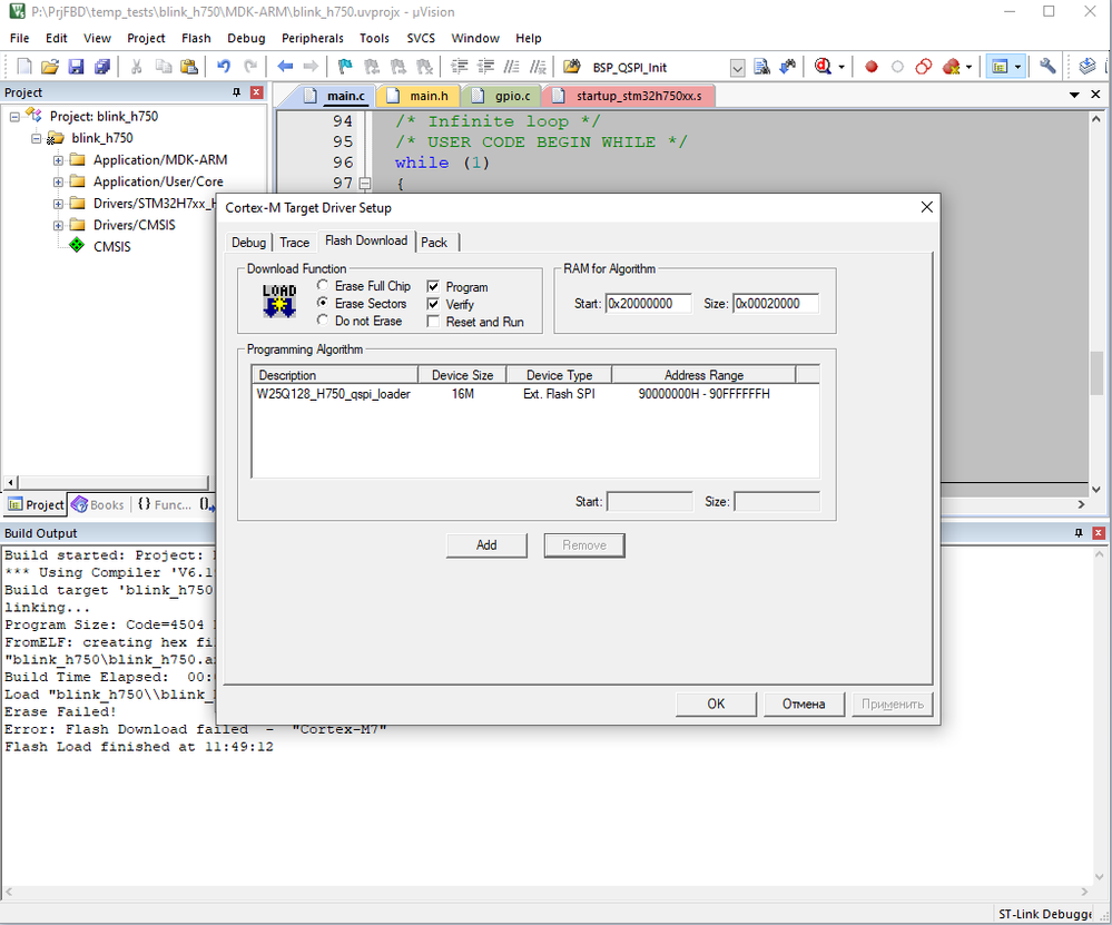

2024-08-16 1:02 AM
How is it building for the 0x30000000 address space? The loaders header describes the 0x90000000 address space which is why Keil complains there's no Flash algorithm associated with it.
2024-08-16 1:08 AM
This is an application project setting.
I think it does not affect. It works on another board.
2024-08-16 1:21 AM
I'll have to check the manual, is it a secondary mapping for the QSPI address space or RAM?
I can change the mappings in the loaders header, but you should see the current coverage when selecting the Flash Algorithm tab via the debug settings.
2024-08-16 1:32 AM
Addresses 0x300ххххх are secondary mapping for RAM address space for Ethernet and DMA UART buffers. Keil just complains that there are no algorithms for writing to RAM.
It doesn't matter. I'm sewing the project from address 0x90000000. And it will work when the application is already launched from address 0x90000000.

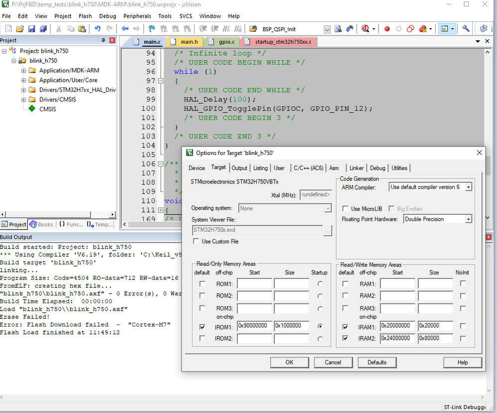

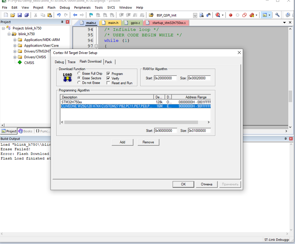

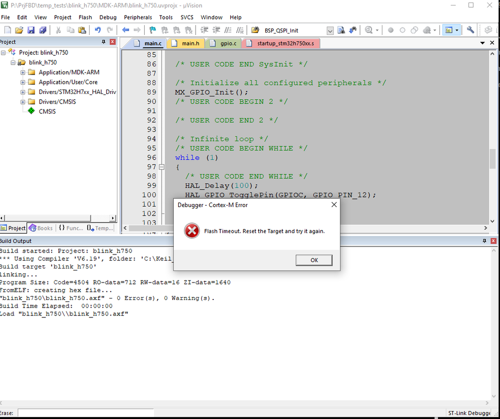

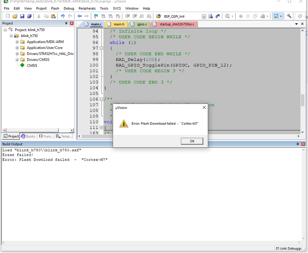

2024-08-16 1:59 AM
A simple LED blinking project, it also doesn't load with my bootloader.
And it doesn't load with your bootloader either.
