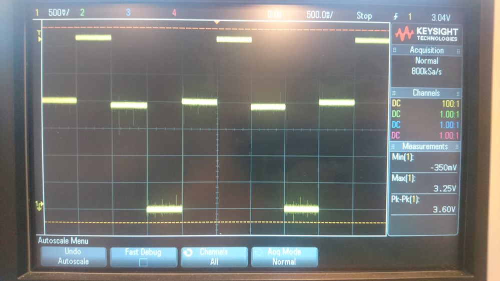

Hi, I've made a pcb using the stm32F446 mcu, 64 pin package, but I have a problem with it. I have four LED's attached to pa4 to pa7. Two of these work fine, but the ones on pa6 and pa7 only lights up entirely when both are on. I tried to remove everything attached to the pins, and saw on an oscilloscope how the output isn't the supposed 3.3v, unless both are on.
From here, you can see four stages: {both off},{ pa6 on, pa7 off}, { both on},{ pa6 off, pa7 on}. The probe is only measuring pa6.

What's with all this taking photographs of the screen of a digital scope?
It can give you a screenshot straight to a USB stick - without all that glare, keystone, etc ...

The waveform is a different issue and indicates short between the pins.

Hooking boot0 to ground solved the problem of going to the bootloader. But the waveform is still a problem. I've had the pcb under a microscope to check for any shorts, which are not present. Furthermore, I've tried to measure the resistance between the two pins when no power is supplied, and it is 1.5 Ohm. This is also checked on a mcu not connected to anything, where the same resistance was measured.

When in a lack of a USB stick in the lab, the camera is faster. However, I surely agree with you.
