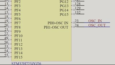

I work with the eval-board Nucleo h743ZI. I implemented sine wave playback using the DAC and DMA, and everything worked very well.
After that, I designed my own board with the same microcontroller and added an external 25 MHz crystal.
I couldn’t get the 25 MHz clock to work.

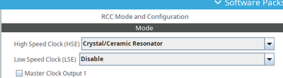

This is the cofiguration:
I try to debug my code and I saw that I get error at
SystemClock_Config:
Error_Handler();
here:
I switched to using the internal clock of the MCU to work with HSI.
The code runs normally, but I don’t see any signal at the DAC output.
This is the configuration:
Thank you very much

You set the crystal input to "bypass" - you use really a crystal or an oscillator? (this works not for plain crystal.)
For crystal set it to ...crystal ..resonator.

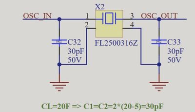

I attach what I work with.
and what about work with the internal clock? HSI? why is not work also

so you have a plain crystal -> set in Cube :
your cer.caps at the crystal are way to big , for 25M : try 6pF or ... 10pF .

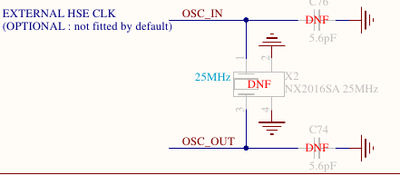

for 25M crystal typ. : 2x 5.6 pF (on nucleo board MB1363 , dnf)
What you have now ? H743 or H723 ...?
