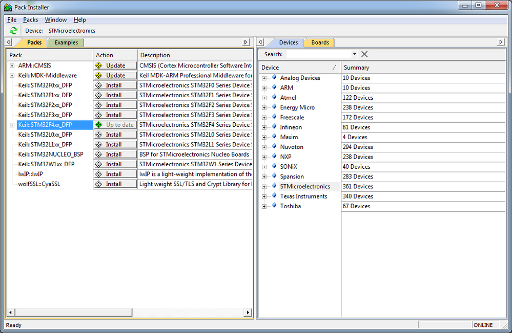

We don't reproduce your issue. Have you used MDK pack installer to download latest pack for STM32 F4?We’re moving the ST Community to a new platform to give you a better and more reliable community experience.
