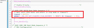

The debug is a bit tricky mainly because CM4 enters the low power mode:
I suggest you to comment out these lines on CM4:
HAL_PWREx_ClearPendingEvent();
HAL_PWREx_EnterSTOPMode(PWR_MAINREGULATOR_ON, PWR_STOPENTRY_WFE, PWR_D2_DOMAIN);
And for CM7 comment out these lines:
timeout = 0xFFFF;
while((__HAL_RCC_GET_FLAG(RCC_FLAG_D2CKRDY) != RESET) && (timeout-- > 0));
if ( timeout < 0 )
Error_Handler();
timeout = 0xFFFF;
while((__HAL_RCC_GET_FLAG(RCC_FLAG_D2CKRDY) == RESET) && (timeout-- > 0));
if ( timeout < 0 )
Error_Handler();
Please refer also to this article.
