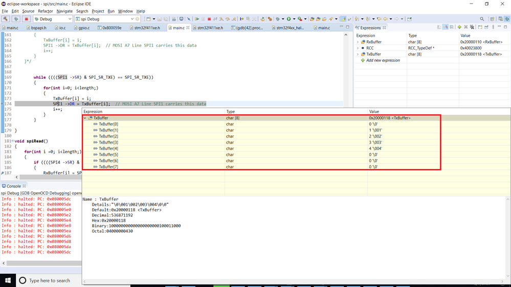

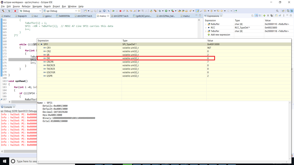

I've edited code as you've mentioned above, Still I couldn't find an changes also the data isn't reflected/ written to SPI Data register. I have attached screenshots for your reference. If subsequent read and write is a problem, I had change the code such that It performs only spiWrite(), still the data is not written into the register.
while ((((SPI1 ->SR) & SPI_SR_TXE) == SPI_SR_TXE))
for(int i=0; i<length;)
TxBuffer[i] = i;
SPI1 ->DR = TxBuffer[i]; // MOSI A7 Line SPI1 carries this data
i++;
