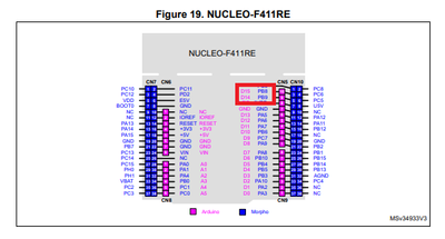

I used STM32CubeMX to set up a Nucleo board (STM32F411RE) to communicate via I2C with a ADXL345 accelerometer.
- RCC & clock settings at default
- SDA on PB9 and SCL on PB8
- I2C Fast Mode
- targeted MDK-ARM toolchain
- generated code

I compile, all's fine, no errors, no warning. Download to the board, no issues. Open the debugger & run and get nothing! No values being read...
I've tried 2 different ADXL345s neither give any values.
ADXL set up the same as the pic below (R - 4k7)
Anyone see anything obvious?
EDIT:: I added a function to see if there was a device attached it comes up "NO" everytime

EDIT 2:: I'm an ***, I had the wrong pins in the Nucleo board wired up!
2025-01-17 12:58 AM - last edited on 2025-01-17 2:53 AM by mƎALLEm
Yes thanks, I had the wrong pins in the Nucleo board wired up and the problem was matching the Nulceo board breakout header pins with the MCU pins. In my case I needed access to PB8 & PB9 which are found on the Arduino header at D15 & D14 respectively.
