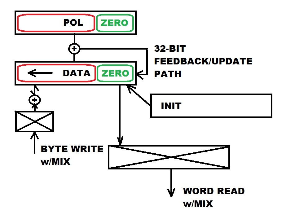

2024-10-13 6:07 AM
The polynomial left aligns, so the top end bit abuts the end of the register for the application of the data and the feed back. Consequently the LOW order bits not used by the polynomial can be ZERO
