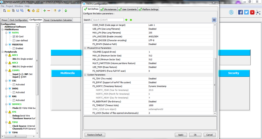

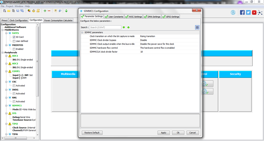

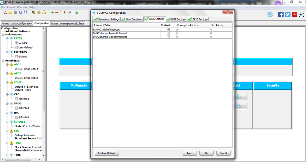

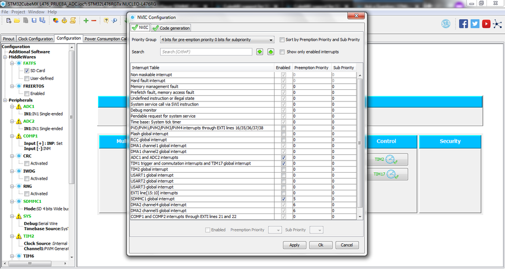

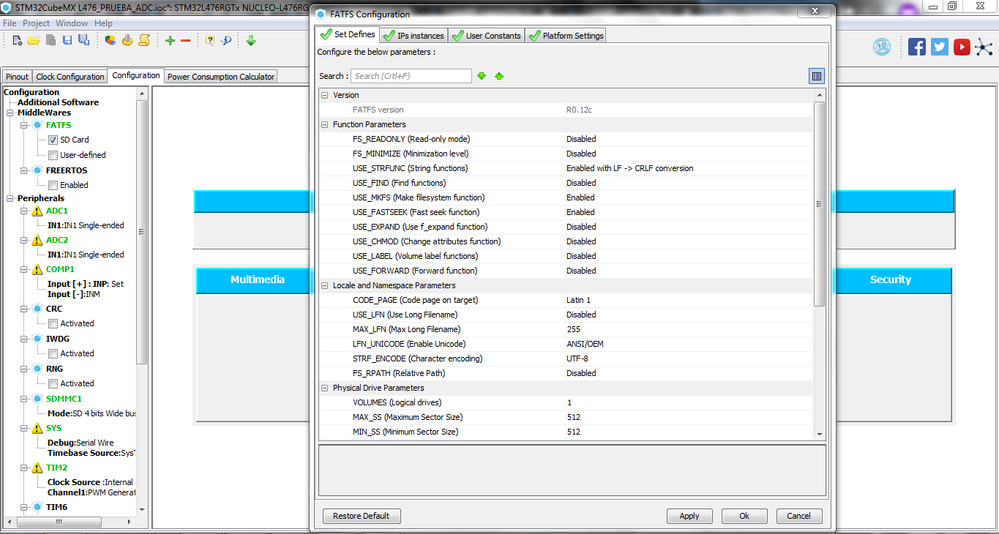

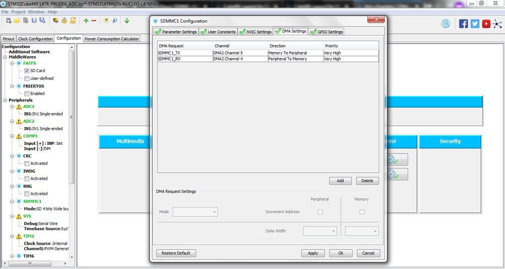

Since a couples days ago I'm trying to set a project in which I can use a micro SD card using the nucleo board L476RG. I'm using CubeMX 4.24 and the HAL library 1.11 for L4 for making all the settings and I also checked the example that is provided for the L476 eval board. I think that all the settings are right, I compare it with the example and it is almost equal. Some captures from cubeMX:

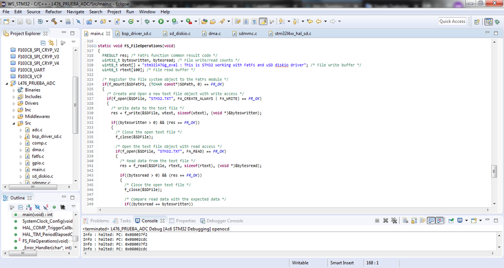

After doing all the configurations I generated the code, So I copied some parts of the example and added to my code. I started with this:
if(retSD == 0)
{ if(BSP_SD_Init() != HAL_OK) { Error_Handler(); } res = f_mkfs(SDPath, FM_ANY, 0, workBuffer, sizeof(workBuffer)); if (res != FR_OK) { Error_Handler(); } }But the function
f_mkfs
always returned FR_DISK_ERROR. So I check the forum and I find that changing the name of the SD callback functions could help to avoid the error. So I changed from sd_diskio.c://void BSP_SD_ReadCpltCallback(void)
void HAL_SD_RxCpltCallback(SD_HandleTypeDef *hsd) { ReadStatus = 1; }//void BSP_SD_WriteCpltCallback(void)
void HAL_SD_TxCpltCallback(SD_HandleTypeDef *hsd) { WriteStatus = 1; }And I comment those functions from bsp_driver_sd.c.
After did that, the SD_WRITE function works and the
f_mkfs
returned FR_OK, also I can mount the unit but when I tried to open or create a file the function reaches the timeout and return error. I found that the RxCallback is never reached when the f_open function is called.I'm not sure, but I think that there is an error with the DMA configuration or maybe could be a harware error, here is a picture of the board with the adapter:

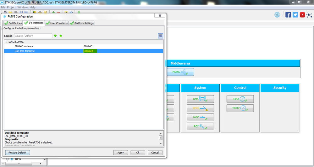

,Thank you so much for your fast reply. In fact I checked other forum and I found that you could configure the polled mode in the FatFs button by disabling the DMA template in the IPs instances:
In polled mode works fine, in fact I didn't change any of my code and it works in the first attempt (even with my handmade micro SD adapter ) and for my application is enough. However, the DMA configuration let me a doubt: why the Tx mode reaches the interrupt but the Rx don't. Hope that ST CubeMx team could fix it!

The code in bsp_driver_sd.c clashes with some of the code in sdmmc.c
SD_DMAConfigRx() in bsp_driver_sd.c configures the wrong DMA channel and interrupt
