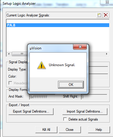

I use STM32f103RCT6 to blinking led in pin A8 with 1 second delay, and i try to use logic analyzer to see whether it's right. However, when i setup in ''Current Logic Analyzer Signal'', i write PA.8 in it and it say ''Unknown Signal''. I was trying write everything ''PORTA.8'',''PortA.8'',''PA8'' but it always say ''Unknown Signal''. What signal' name i should write in it???

Keil's Logic Analyzer is not a 'hardware' logic analyzer, and do not monitor I/O pins. It is also limited by the debugger and the MCU core you are using.
See below.
Cheers,
Alex.
_____________________________________________
From Keil uVision User's Guide: Logic Analyzer
µVision User's Guide: Restrictions
RestrictionsWhen debugging on hardware, the number of items that can be defined in the
is restricted by the microcontroller core (refer to Access Breakpoints inhttp://www.keil.com/ulink/cmp.asp
). Many more different items can be defined in simulation mode.The Logic Analyzer can record changes of:
struct
members.The Logic Analyzer
cannot
