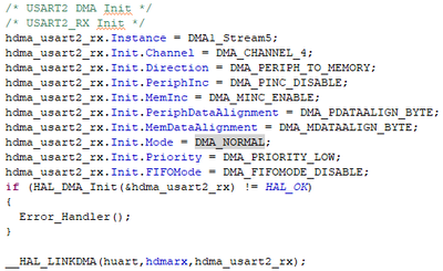

2024-05-24 12:11 AM
Hi, following configuration was used for the DMA.
2024-05-24 12:16 AM
HAL_UART_Receive_DMA() returns immediately to allow you to get on with "other things" while the reception actually happens. You have to wait for a callback to know that the reception has actually happened.
On the other hand, HAL_UART_Transmit() (without _IT, without _DMA) stops execution of your code until the last byte is sent.
If your other device starts sending before your HAL_Delay(1); has completed (so before you tell the UART to start listening with HAL_UART_Receive_DMA) then you'll miss some or all of the message. So from a "sequencing" point of view you'll have to call HAL_UART_Receive_DMA() before HAL_UART_Transmit().
But (and this is an important point) I don't know if calling HAL_UART_Transmit() while there is an ongoing HAL_UART_Receive_DMA() will upset the receive or not. This information is something that should be included in HAL documentation. I know I sound like a broken record on this point, but I don't think HAL is adequately documented and so I avoid it where I can, instead writing my own code using the Reference Manual. I strongly recommend that people try to read the appropriate chapters of the Reference Manual for their stm32 to know what the HAL calls are trying to do.
