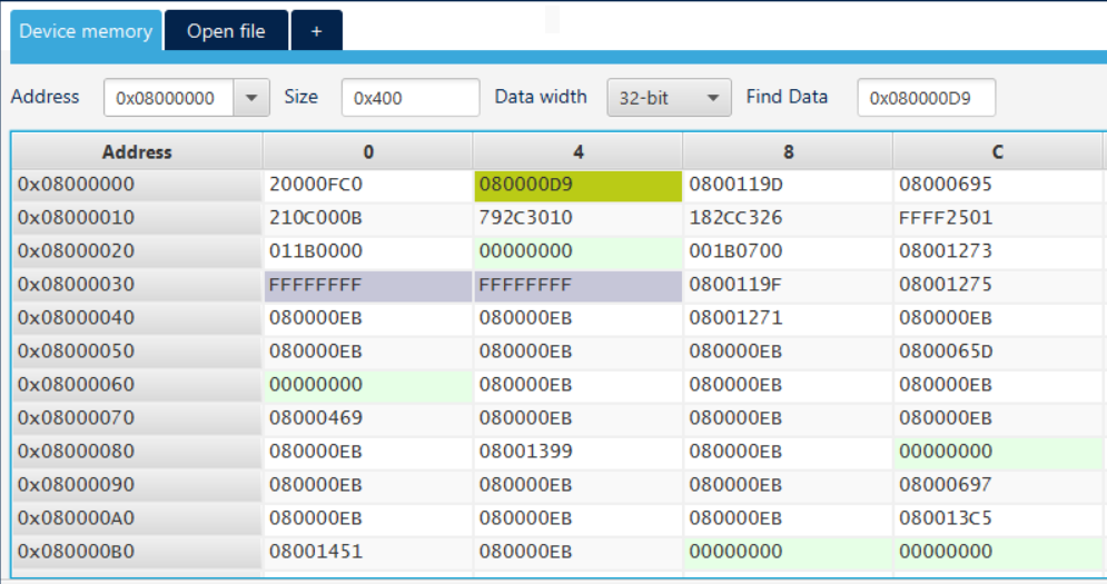

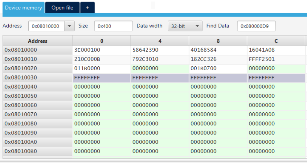

Here is the data I saved in bank2 page512:
Here is the data stored in flash bank1 page0:
This is the data I am reading:
Read Buffer:
20000FC0 080000D9 0800119D 08000695
210C000B 792C3010 182CC326 FFFF2501
011B0000 00000000 001B0700 08001273
FFFFFFFF FFFFFFFF 0800119F 08001275
As you can see, underlined values not are only wrong but they belong to data in the page0 and I don't have any idea how the iteration can fetch these values out of the range of the address.

From your screenshot, ALL of the values match up with values in 1, not just some. Some of them happen to be the same in both banks.
