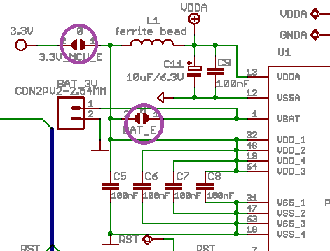

I'm not sure what you want me to do about this.
The current drawn by VBAT will be of most interest as the internal regulator should switch off in STANDBY. From my own F1 design I recall drawing 180 uA from my lithium battery (3.7V) in STANDBY, and in STOP it was below 1mA (800-900 uA). This was a board designed to be able to turn off and be low power, not some random board from the internet. You need to consider what else on your board is pulling current, and be able to break the supplies to the F1 itself to quantify what it is using vs the rest of the design. I'm not sure if the Olimex board was designed with that much consideration.2013-05-20 11:09 AM

That's getting a bit beyond my level of participation. You need to be measuring the current of the STM32 at the solder bridges on the board that break the supply feeds to the part.2013-06-25 11:07 PM
