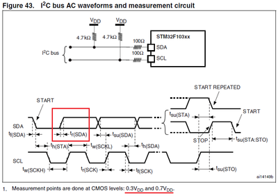

But why is the rise time in Figure43 (IIC) from 0.3VDD to 0.7VDD?

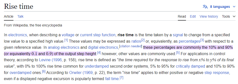

It is pretty standard practice across the industry to specify risetime between the 10% and 90% points
https://en.wikipedia.org/wiki/Rise_time#:~:text=these%20percentages%20are%20commonly%20the%2010%25%20and%2090%25%20(or%20equivalently%200.1%20and%200.9)%20of%20the%20output%20step%20height
As the name suggests, it's just about the rate of rise - it really has nothing to do with the logic level thresholds.
Sorry, I can't open the website.
In IIC , the rise time is from 30% to 70%. You can see this in Figure43 of <STM32F103xC, STM32F103xD, STM32F103xE (DS5792 Rev 13)>. But according to what you mean, the maximum of the rise time in IIC  is from 10% to 90%?
You can see the rise time of IIC in Figure 48 of <STM32F103xC, STM32F103xD,STM32F103xE DS5792 Rev 13> or Figure 43 of <STM32F103xC STM32F103xD STM32F103xE Rev 5>.

No, you're missing the point.
The point is that the points used to measure rise time are arbitrary - they are not related to the logic level thresholds.
Rise time is about speed - not levels.
