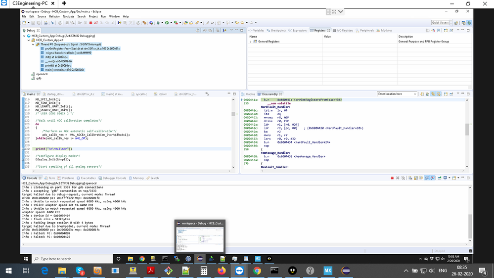

I am working on a STM32F103VEtx MCU. In my firmware I have redirected the printf function to a UART for debugging purposes. When I start running the code, the printf function causes the hard fault handler to hit. Please see the call stack attached below
Thread #1 (Suspended : Signal : SIGINT:Interrupt)
prvGetRegistersFromStack() at stm32f1xx_it.c:109 0x800441a
<signal handler called>() at 0xfffffff9
std() at 0x8007abe
__sinit() at 0x8007b76
printf() at 0x8006dac
main() at main.c:130 0x800400c
It seems like std() function call triggers the hard fault. Please help me to figure out and fix the issue.

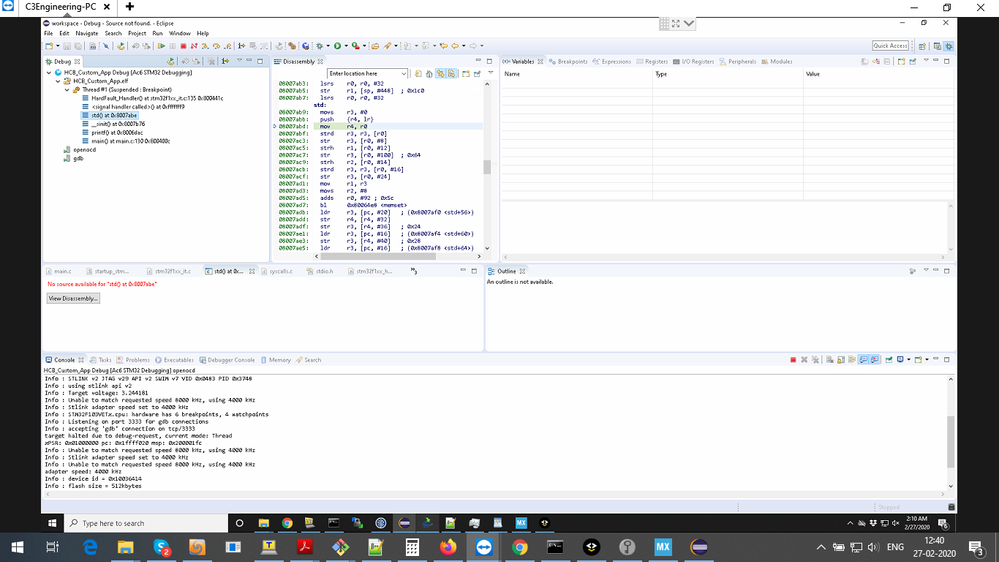

Attaching the disassembly code snippet where issue is happening
std:
08007ab9: movs r3, #0
08007abb: push {r4, lr}
08007abd: mov r4, r0
08007abf: strd r3, r3, [r0]
08007ac3: str r3, [r0, #8]
08007ac5: strh r1, [r0, #12]
08007ac7: str r3, [r0, #100] ; 0x64
08007ac9: strh r2, [r0, #14]
08007acb: strd r3, r3, [r0, #16]
It seems like hardfault is triggered from the line of code "08007abd: mov r4, r0". When clicking the std() function in call stack it is jumping to above mentioned line of code. Attaching the screenshot for more clarification.
2020-02-27 12:37 AM
A mov won't cause any fault, it's just moving a value of one register to another. It's most likely the next one, storing two words to memory pointed by [r0], which is the first parameter of the function call. So this function is called with a NULL pointer argument.
Get the sources of your C runtime library, and look into it, what could cause it to be called with a NULL pointer.
