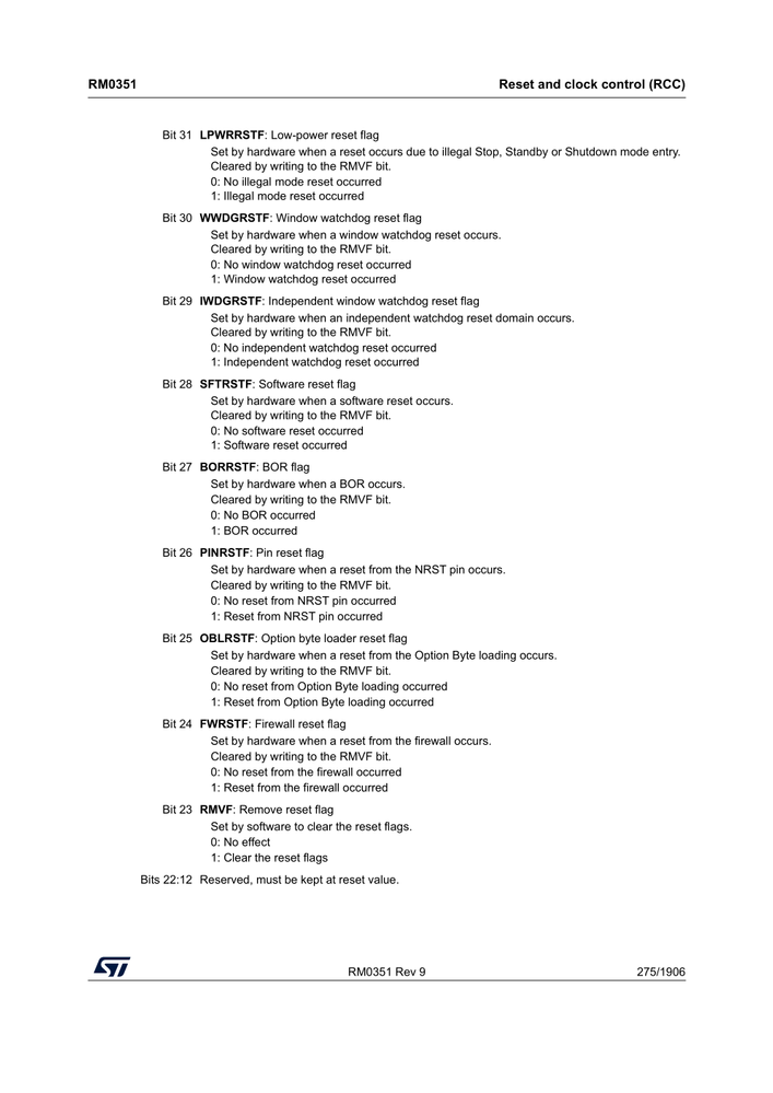

I meant https://raw.githubusercontent.com/STMicroelectronics/STM32CubeL4/master/Drivers/CMSIS/Device/ST/STM32L4xx/Include/stm32l471xx.h and you have it under a similar path at your computer...
...but I spoke too soon: unlike some other STM32, the 'L4xx appears to have no PORRST flag in RCC_CSR:
0693W00000aIWTyQAO.pngMaybe POR is indicated by absence of any other flags being set in that register, but that needs some testing.

Piranha
Chief II
Maybe read the reference manual?
The device has an integrated power-on reset (POR) / power-down reset (PDR), coupled with a brown-out reset (BOR) circuitry. The BOR is active in all power modes except Shutdown mode, and cannot be disabled.
During power-on, the BOR keeps the device under reset until the supply voltage VDD reaches the specified VBORx threshold.
Therefore at least for these devices POR=BOR and it sets BORRSTF. And in addition the PINRSTF will always be set.
