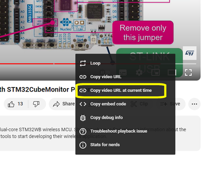

You can link to a specific time in a YouTube video:
eg, https://youtu.be/7IVs-nuoXj8?t=736

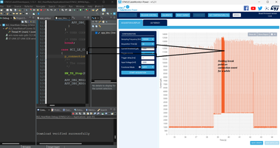

Prior to adding PIN13 and PIN5 to be analog, I Ran a quick test , programmed the WB55 in debug mode (CubeIDE) , and ran.
Have some weird base current of 1 mA on advertising during sleep. (BleHeartRate example)
But then, I do get to hold a breakpoint on connection event , debug doesn't break. But I see the current jump high to 3mA while I am holding the break point. here:

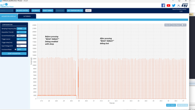

Exiting debug:
Pressing the" Reset button" on WB55 does not exit debug.
Only if I press "RESET TARGET" on STM32CubeMonitor-Power than I lose it. And only then I see datasheet sleep currents. (3uA). See here:
So what's going on? and what is then the correct way to keep debug with sleep if I need it?

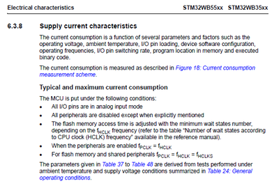

Current consumption figures are given in the datasheet:
As it says, the consumption depends on many things - and not just the physical characteristics of the chip but also the nature of the particular application (hardware & software).
So it's really not possible to give a simple statement, "current consumption is X".
But it would be useful if ST would give some figures for a specific reference application on a specific board under specific conditions - with full details of the conditions of measurement.
