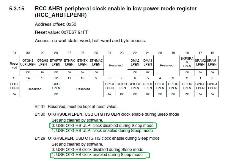

Were you able to find a fix for your problem? I am facing a similar problem with USB OTG HS using embedded Full speed PHY on a custom board with an F207 chip. Using WFI results in the control transfers going haywire. I have seen the controller sending some 1000 bytes out on the bus where it was supposed to send an eight byte setup packet. It all goes away if I remove WFI from my system. Regards, Awais2012-12-15 9:43 AM
Dear all,
Thank you for posting this interesting issue, Here I give the details of the behavior and THE solution :This unwanted behavior is caused by bit ''OTGHSULPILPEN'' that is set by default in register AHB1LPENR ( See below) , reset state is [1].
When working with our High Speed peripheral in full speed mode and you want to enter SLEEP using WFI cortex-M low power mode, the firmware side should configure these bits in this way :
1) Clear bit
OTGHSULPILPEN
in register AHB1LPENR 2) Set bit OTGHSLPEN in register AHB1LPENR ( already set after reset)O
ur Firmware library
and USB examples will implement this change in
future.
Cheers, STOne-32 { your STM32 Moderator }2012-12-15 11:57 AM
Ok, well that's interesting. None of my boards have HS/ULPI, which explains my lack of issues in this regard.
