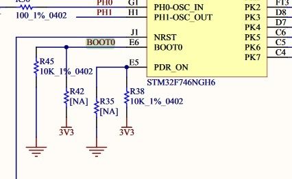

2018-05-30 9:53 AM
http://www.st.com/en/evaluation-tools/32f746gdiscovery.html
This is the board... I can't locate the pin.. think it is not exposed
2018-05-30 11:48 AM
Try the ST-LINK Utilities with the ''Connect Under Reset'' option, and if that connects Erase the part.
Short R42 pads
2018-05-30 12:19 PM
Thanks ! At the end, looking the schematics I got around with exactly this solution
