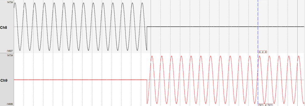

While I was calibrating each ADC channels, I realized a strange behaviour. I applied a signal to each channel and ADC1 channels were measured as expected. However, when I applied signal to Ch8, ADC2 measured as like there is no signal applied to Ch8. I spent few hours to understand what is going on. I checked ADC settings in CubeMX and I also checked ADC registers about ranking, etc, I checked hardware as well if there is miss routing etc. After sometimes, I realized when I apply a signal to Ch8, Ch8 result is written to Ch9 place in ADC12_Result register. If I applied to signal to Ch18, the result is written to Ch8 place in ADC12_Result register. So, I tested each channel one by one and DMA is written data to wrong places. There is one channel shift. So similarly, Ch 9 -(5)- (14) result is written to Ch 5 (14)-(18) place in SRAM by DMA.

I also realized that after reset of the microcontroller DMA writes ADC1 and ADC2 results to correct places in RAM space for awhile. After sometime, DMA starts to write ADC2 results to wrong places and it continuously writes to wrong places after that. I have some screen shuts about it.
