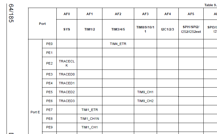

I am working on a sine wave program as a part of an Amateur Radio project. I have a working code producing what I want using TIM3-- PWM and PORTC. I am unfortunately unable to neither change the TIM3 to any other TIM nor am I able to change my PORTC to PORTE. The code follows closely the PWM example by STM and Andrew Markham's approach to the interrupt handle. I can post code, although I am not sure of the proper messaging protocol for code in this forum. Since the code is working fine using TIM3 and PORTC, I would have thought that either change would have been a simple task. I have of course tried to change only one at a time. Changes compile fine with no errors; but no output is found on the appropriate pin using an oscilloscope, except the TIM3/PORTC arrangement. Thanks for any help.
Jack (W0FNQ)2014-05-10 8:24 AM
You can paste source using the Format Code Block (Paintbrush [<>] icon). I want to see complete compilable code.
Timers have specific pin utilization, so you can't randomly associate them. The part data sheet should show what routing options are available.2014-05-10 10:15 AM
Thanks for reply. I am hoping to use TIM4 and PORTE pin 2. Here is the code:

2014-05-10 11:53 AM
PE2 has no timer associativity. Please refer to the
http://www.st.com/st-web-ui/static/active/en/resource/technical/document/datasheet/DM00037051.pdf
for your part. PE5/PE6 are TIM9_CH1 and CH2 respectively2014-05-10 12:13 PM
thanks for the reference pointer. I will explore other possible combinations.
