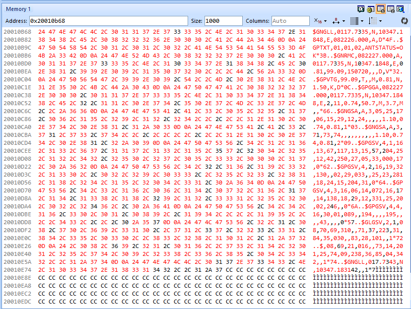

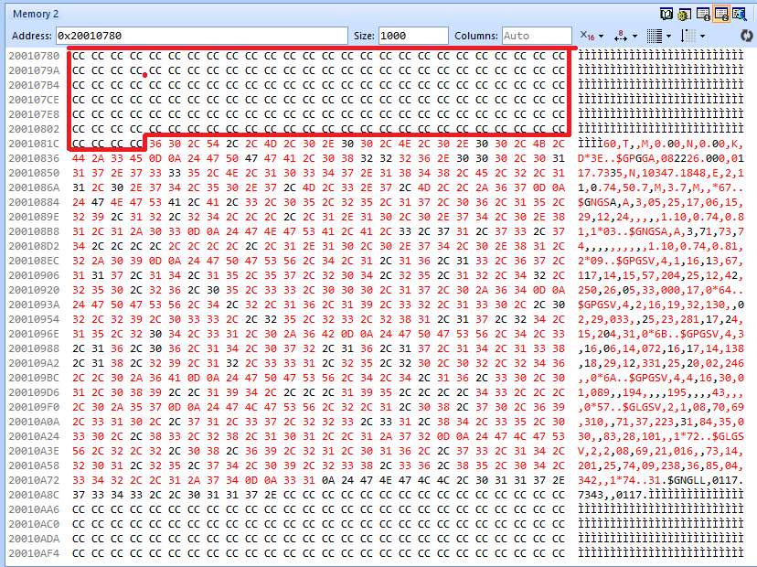

I fove the following code:
void EXTI9_5_IRQHandler(void)
if(GPSDMAStart == 1){
if(currentPing == 0 && currentPingProcessed == 1){
/* currently pong, switch to ping */
hdma_uart7_rx.Instance->CR &= ~(1 << 0);
hdma_uart7_rx.Instance->NDTR = 1000-1;
hdma_uart7_rx.Instance->M0AR = uartbufPing;
hdma_uart7_rx.Instance->CR = hdma_uart7_rx.Instance->CR|0x0011;
huart7.Instance->CR3 = 0x00000041;
currentPing = 1;
currentPongProcessed = 0;
}else if(currentPing == 1 && currentPongProcessed == 1){
/* currently ping, switch to pong */
hdma_uart7_rx.Instance->M0AR = uartbufPong;
currentPing = 0;
currentPingProcessed = 0;
main(){
Uartret = HAL_UART_Receive_DMA(&huart7, uartbuf, 300);
memset(uartbufPing,0xCC, 1000); <--- fill ping and pong with 0xCC
memset(uartbufPong,0xCC, 1000);
GPSDMAStart = 1;
while(1){
uint8_t rret = 0;
if(currentPing == 0 && currentPingProcessed == 0) {
currentPingProcessed = 1;
else if (currentPing == 1 && currentPongProcessed == 0){
currentPongProcessed = 1;
}The EXTI9_5_IRQHandler interrupt handler comes very sec, Running the program give me the following output from both memory:
Pong:
ping:
My question is why is the ping does not start from the top ? and it consistently starts with the same offset, am I doing anything wrong here ?
