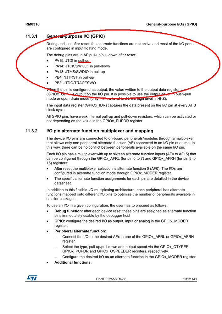

When there's no code in FLASH or you select the appropriate BOOT setting, the stm32 will start up running the ST-supplied bootloader.
This bootloader will use certain pins to allow you to download your firmware e.g. over a UART or I2C. See the data sheet for details.
Also coming out of reset, any debug pins (JTAG or SWD) will be enabled and pulled appropriately.

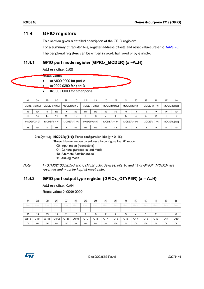

> The Reference Manual says the reset value for GPIO_MODER is 0, so all GPIO are inputs.
No, it doesn't say so.
2020-01-30 7:07 AM
Youre right!
I misunderstood, thanks. :)
