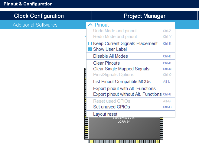

2019-02-04 8:57 AM
Using STM32CubeMX, you should be able to export the pinout to a csv file:
-Amel

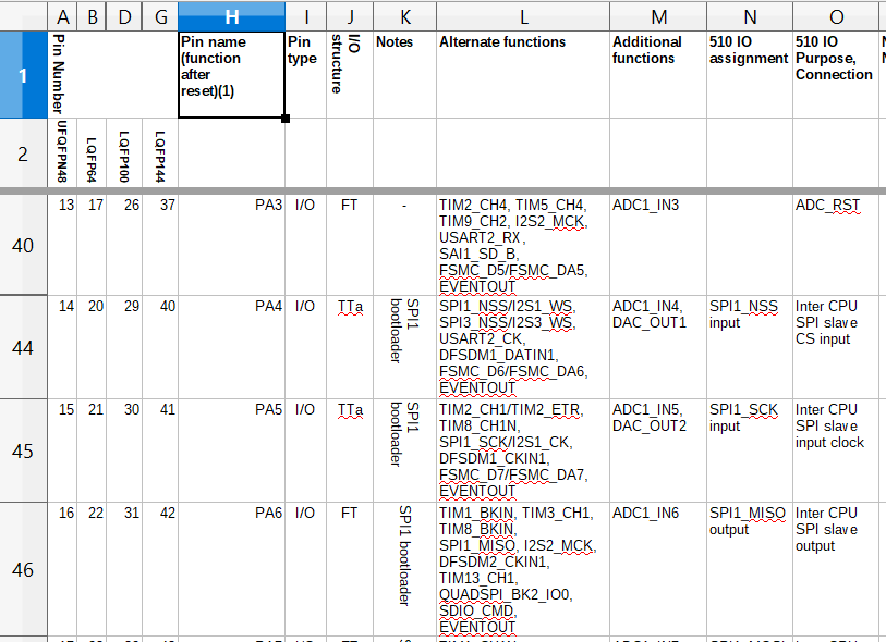

2019-02-04 10:52 AM
Thanks @Amel NASRI but that is not quite what we need. Especially when trying to determine which package to use, we need something more like the table in the datasheets. Also when trying to prototype with a large package (for example on Nucleo) for a product that will use a smaller package, we need all variants in one sheet. Example below,
Thanks,
Best Regards, Dave
