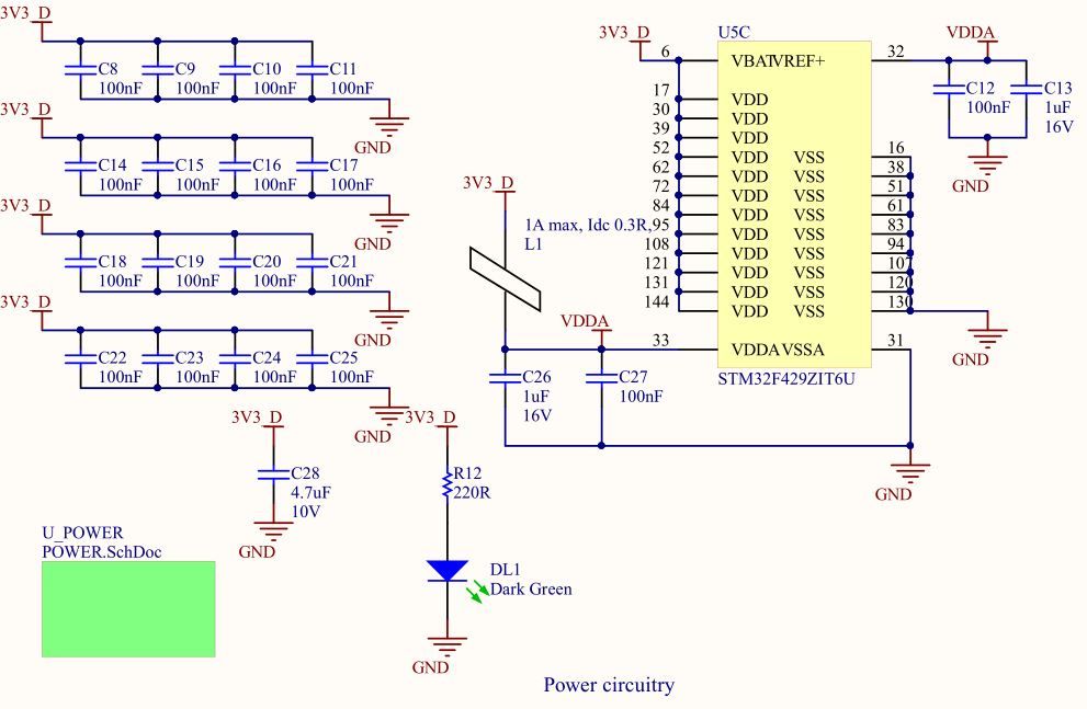

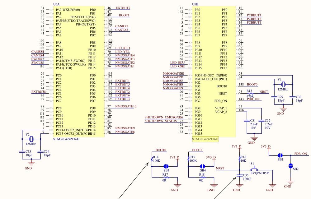

My MCU connections, all solder bridges are unpopulated:
MCU power circuit:

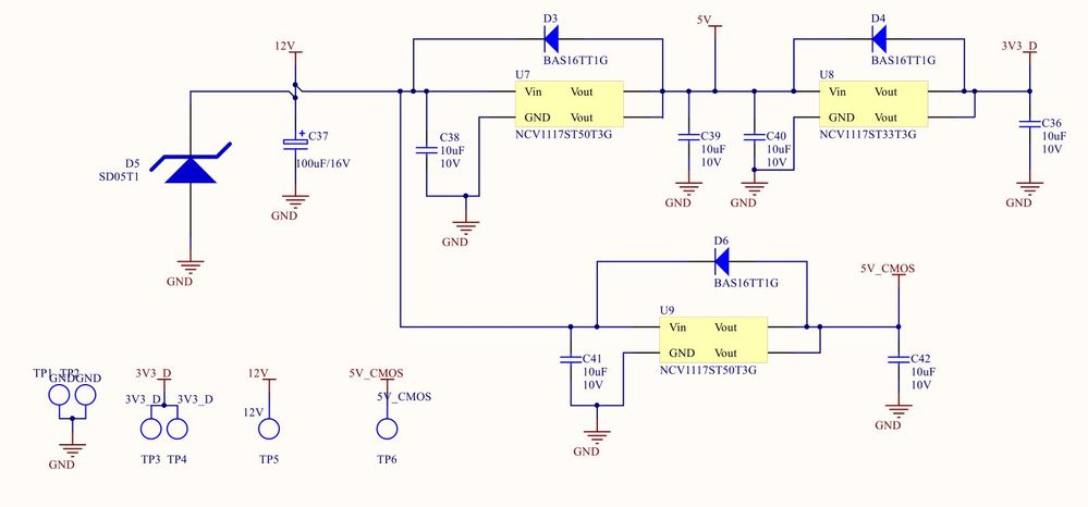

and regulators, D5 and C38 aren't populated:
