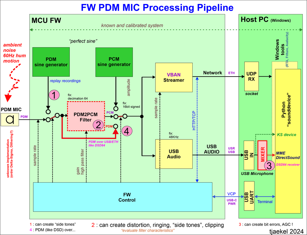

Instead of doing the PDM2PCM conversion (inside MCU) - send the PDM bit stream to a host PC at it is. We can do the PDM to PCM conversion, e.g. with Python scripts, on a host PC. Get the PDM bit stream directly, e.g. via USB as "Audio Input" and Python "sounddevice" or "pyaudio". Do the conversion on PC (which is faster, more flexible, allows to investigate the PDM MIC signal, e.g spectrum, which Delta-Sigma order, ...).

When an USB Recording Device pops up in Windows, e.g. as Digital Microphone Input, in a Python script (with "sounddevice") you will find several different drivers for the same interface, e.g. as "MME", "DirectSound", "WSAPI" and also as "WDM-KS".
All input devices go via the Windows Sound Mixer (e.g. for the volume control, to add effects like bass boost). And this creates "bit errors": the LSB can be changed, it is not anymore the original data (bit stream) which was sent/received via USB.
But if you use the "WDM-KS" device - it bypasses all this stuff and the bit stream remains bit-error-free.
For PDM (DSD) it would be very important to avoid any "bit-flip" even just on a 'LSB" because this would result in a huge frequency change (and sound artefact), because for PDM every bit matters!

Here my audio pipeline in STM MCU (Portenta H7) I have in place:
