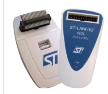

Which ST-link you are referring to? a stand alone ST-LINK like this one:?

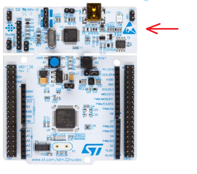

Or an ST-LINK that you've de-attached from a Nucleo board?
For the second one yes you can do it. For the first one, not possible.
Meanwhule, you can use any USB to UART bridge to connect your PC/USB to STM32/U(S)ART.

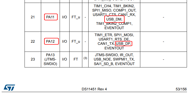

@Raphael716 wrote:was wondering if it is possible to do it only via USB with the pins PA11 and PA12
Yes, the STM32L432KC has USB on pins PA11 and PA12:
https://www.st.com/resource/en/datasheet/stm32l432kc.pdf#page=53
via: https://www.st.com/en/microcontrollers-microprocessors/stm32l432kc.html#documentation
That will mean that you will have to do a complete USB hardware design on your custom board, and provide a complete USB software implementation in your custom software.
Depending on your level of both hardware & software experience, you may find it easier to just use a USB-to-UART adaptor...
(avoiding the complexities of USB hardware & software implementation is exactly why USB-to-UART adaptors exist)
