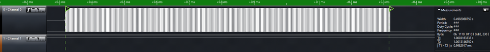

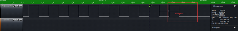

Yes, thank you for your answer.I didn't upload the more detailed implementation code.So I will upload part of the implementation code.I have considered your suggestion, but I think it is not for that reason. I am sorry that I did not make the situation clear.I'm going to output an indeterminate number of pulses in 1ms, so I'm going to select some pulses to verify that.When I output less than 500 pulses, the number of pulses is actually accurate.I get one more pulse when I send 500 or more pulses.And I catch the wave in photo,from the photo we can see the extra pluse.
