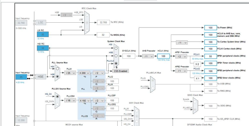

0693W000008xst5QAA.pngThe reset is caused by the watchdog when the MCU gets stuck in the hard fault handler.
The +3.3V is delivered by a LP38693MP-3.3 (500mA). I probed with a scope, there is not supply dip when or before the fault occurs.
A 25MHz external crystal is used. I've also probed the crystal which doesn't seem to stop oscillating except for a short time when the fault occurs in debug only. The DC drops to 0 so I expect the crystal driver just stops when the debugger pauses.
With no debugger, the MCU stalls but the crystal doesn't stop oscillating.
The chip package is LQFP-64 and doesn't seem to match the evaluation boards for this family.
I think I will try different firmwares, enabling or disabling some peripherals and use internal RC clock instead to try to get more insight into the cause.

Add also a different PLL setting (e.g. lower M & lower N) to the experimentation mix.
