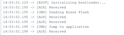

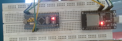

this was my hardware setup @Tesla DeLorean manually controlling the boot pin.
what my condition was i am initialized the bootloader receving the ack 0x79 for that , but the write operation and erase is not done. every time i checked with the cube programmer nothing is erased and written in new. this was my current condition
this was my code:-
