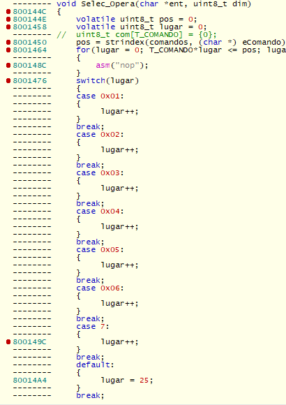

Hi all, how are you?. I'm doing a project with a STM32F103C6 (it has 32KB flash) and I had to activate optimization options to not run out of memory, right now the optimization options is -Og. After activate optimization a function that I have to know the position of a substring and after that I'm trying to use a switch statement that the compiler is killing and obviously I can't but I don't know why.

When the Selec_Opera() function is being executed it can be seen that almost all the switch options are not compiled, some pictures can show correctly what I'm tring to explain.
The following image shows that when I'm doing a debug session the debug file has the text but almost all the "switch" options code hasn't been included in the executable file (I need this)
only option 7 and default are included, I've tried only for test with reduced options and the behavior is the same, only the last numbered option and the default option are included in the code (this can be seen because at left is written the memory position of the instruction)
I've tested the "for" statement and it is working well selecting the position where the string is so I don't know what is happening with the switch.
Can anyone help with this?. Thanks in advance for the help.

No doubt what is happening here is the compiler realizes cases 0 through 7 are the same, so it simplifies it to the following:
switch(lugar)
case 0x01:
case 0x02:
case 0x03:
case 0x04:
case 0x05:
case 0x06:
case 7:
lugar++;
break;
default:
lugar = 25;
break;
}Don't rely on the debugger to accurately reflect the flow of the code when optimized. The compiler can rearrange and simplify things as needed.

2020-08-26 6:49 PM
To understand the generated code look at a disassembly. See how it flows, and how it manages the functionality you expressed in its simplest form.
There is unlikely to be a linear one-to-one relationship between C lines and assembler lines when optimized.
You shouldn't need to single step C code to understand how it works.

Thanks @TDK for the help, this was exactly the problem, a C problem, I need to learn to think in optmimization mode to avoid this from happening again.
