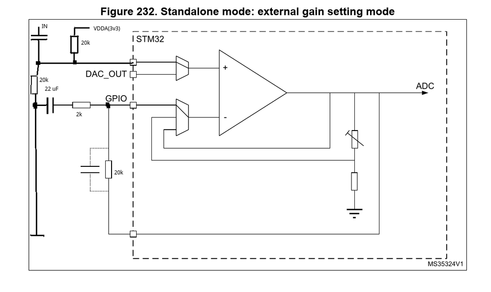

right, ref to gnd. if you want AC amp, need connect external to inv + non inv input.
like this:

Thank you AScha. Am I correct in my presumption that even when we connect the negative input to GPIO, if we want to use PGA, then the bottom part of the voltage divider will still be connected to ground? In such case, is there a way to use PGA and yet have constant bias at 1/2 VDDA in order to amplify audio signal from a mike? Sorry if I am asking something silly, the thing is I am a pianist, not an engineer.
like this:
Thank you for the explanations. It is a pity that in such case I will lose the ability to control the gain through software.
