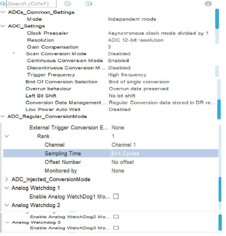

2023-01-05 1:52 AM
sure.
these are the configuration need to take care while designing.
