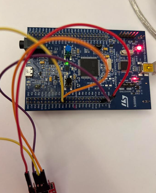

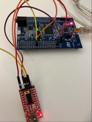

Allright, I tried to send data to my PC using FT232RL. Please see my connection at below image.
I have also edited the code please see below.

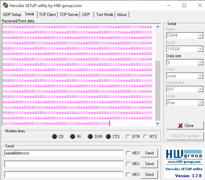

I have opened port COM4 through HERCULES (a program to monitor serial port).
I still CAN NOT see the message sent to PC on Hercules even I see that green LED blinks which is an indication that message is transmitted.
However, even I keep sending bytes to PC via hercules, I can not receive it as I see the RED led blinks.

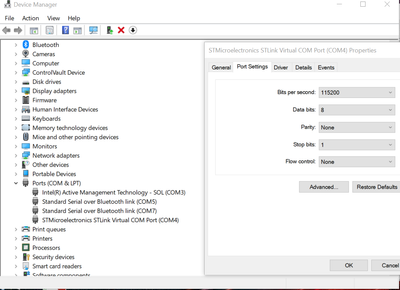

My port settings are as below.
I am veryyyyy confused and would be glad if you could support.
Thanks.

2024-12-26 4:45 PM - edited 2024-12-26 4:48 PM
Yeah, out of focus pictures aren't super helpful. Perhaps you can enumerate actual connectivity?
PD5/PD6
PD5 (USART2.TX AF7) would presumably need to go to the FTDI RX. Perhaps get a scope or logic probe on the signal.
Do you get successful reception of data on the PC? Start with that as Step#1
Blocking and dwelling for 5 seconds to get input on the STM32 probably not ideal. Perhaps use the IT versions so you can get concurrent reception.

Thank you.
It has been resolved by connect the FT232RL to PC via USB.
