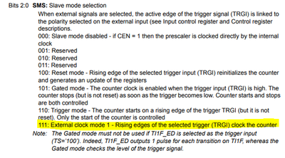

Currently, I have set slave mode as External Clock mode 1 and as trigger source ITR1, and according to reference manual, there is an internal connection with TIM3.
That means the TIM9 clock is connected to the rising edge of TIM3, but on which signal?

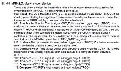

It's connected to TRGO. Looks like an omission on that RM, but it's correct in other RMs for that family:
TRGO is configurable to be any number of signals in the MMS register.

Slave:
With the SMS register I can choose the slave mode as I read here:
If I configure it as External clock mode and if I choose as TS ,'Trigger selection', the value '001' = ITR1, it means that the rising edge of TRGI, in this case the theTRGO set by the MMS register of the master, clocks the counter. So I have to setup a TRGO event to get the clock signal for the slave timer?
So if that's true, after setting the parameters for the waveform, I should choose an TRGO event to have the clock signal for my slave timer and the same signal is my trigger signal. After that the timer starts counting, until the pulse is complete, right?
