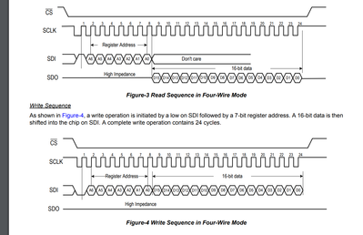

//ATM90E26 SPI sequence
2023-09-05 8:04 AM
Note that SPI is a bit exchange protocol. For every bit you send you receive a bit. So, given the "SPI sequence" you show you must transmit 3 bytes in order to properly set the register address and transfer the 2 data bytes (for either a read or write operation). You must use a 3-byte HAL_SPI_TransmitReceive() for the register read operation.
