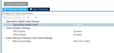

2024-09-17 4:38 AM - edited 2024-09-17 4:50 AM
I believe that I have tried almost everything now, not getting anywhere.
My default settings was MPU NOT used and cache disabled and Speculation Disabled.
Would Any MPU setting improve compared to this?
What else can I do?
Im a bit confused about this:
MPU_InitStruct.SubRegionDisable = 0x87; (for the whole region)
if I change this to e.g. 0 then I get a hard fault.
I have Tried Below: (The FPGA is connected to OCTOSPI1)

sCommand.InstructionDtrMode = HAL_OSPI_INSTRUCTION_DTR_DISABLE;
sCommand.AddressMode = HAL_OSPI_ADDRESS_8_LINES;
sCommand.AddressSize = HAL_OSPI_ADDRESS_24_BITS;
sCommand.AddressDtrMode = HAL_OSPI_ADDRESS_DTR_DISABLE;
sCommand.AlternateBytesMode = HAL_OSPI_ALTERNATE_BYTES_NONE;
sCommand.DataMode = HAL_OSPI_DATA_8_LINES;
sCommand.DataDtrMode = HAL_OSPI_DATA_DTR_DISABLE;
sCommand.DQSMode = HAL_OSPI_DQS_ENABLE;
sCommand.SIOOMode = HAL_OSPI_SIOO_INST_EVERY_CMD;
sCommand.Address = 0;
sCommand.NbData = 1;
/* Memory-mapped mode configuration for Linear burst write operations */
sCommand.OperationType = HAL_OSPI_OPTYPE_WRITE_CFG;
sCommand.Instruction = LINEAR_BURST_WRITE;
sCommand.DummyCycles = DUMMY_CLOCK_CYCLES_SRAM_WRITE;
if (HAL_OSPI_Command(&hospi1, &sCommand, HAL_OSPI_TIMEOUT_DEFAULT_VALUE)!= HAL_OK) {
Error_Handler();
/* Memory-mapped mode configuration for Linear burst read operations */
sCommand.OperationType = HAL_OSPI_OPTYPE_READ_CFG;
sCommand.Instruction = LINEAR_BURST_READ;
sCommand.DummyCycles = DUMMY_CLOCK_CYCLES_SRAM_READ;
Error_Handler();
/*Disable timeout counter for memory mapped mode*/
sMemMappedCfg.TimeOutActivation = HAL_OSPI_TIMEOUT_COUNTER_ENABLE;
sMemMappedCfg.TimeOutPeriod = 100;
/*Enable memory mapped mode*/
if (HAL_OSPI_MemoryMapped(&hospi1, &sMemMappedCfg) != HAL_OK) {
Error_Handler();
Hope somebody can help with this
