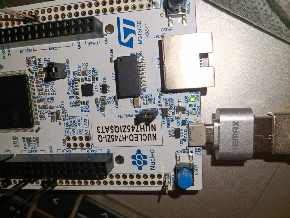

I am trying to enable USB host work. I added HAL_PWREx_EnableUSBVoltageDetector(); into void MX_USB_HOST_Init(void). and followed git examples for H7. But could not make it work((
now green VBUS led is high
But my device is not connected. When I turn on Flesh Driver for 1 sec can see how the blue LED blinks on it. at the code, I stag here:

Do you still have the same issue? If so, do you provide an external power supply when using USB host function?
