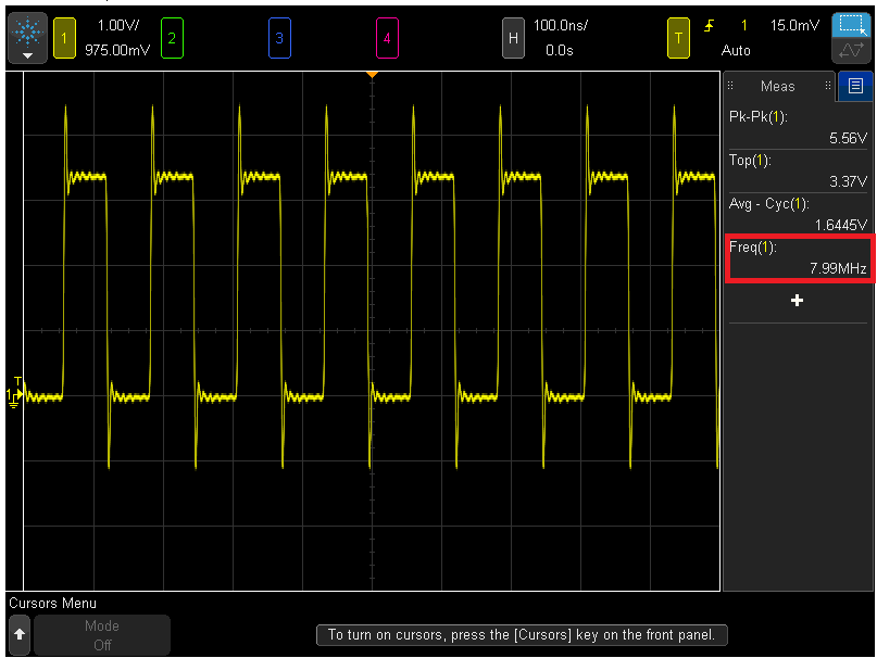

: user manual for STM32 Nucleo-32 board.On table 5, the OSC clock configurations is given.Please verify the following solder bridges connections:This configuration connects the MCO from ST-LINK to OSCIN(PF0) -> HSE BYPASS
The figure below contains the HSE probed on MCO_PA8 pin.
As you can see, a 8MHz clock is provided.
Verify the solder bridges state and give me your feedback.
