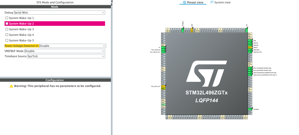

}This are the settings on the ioc project file:

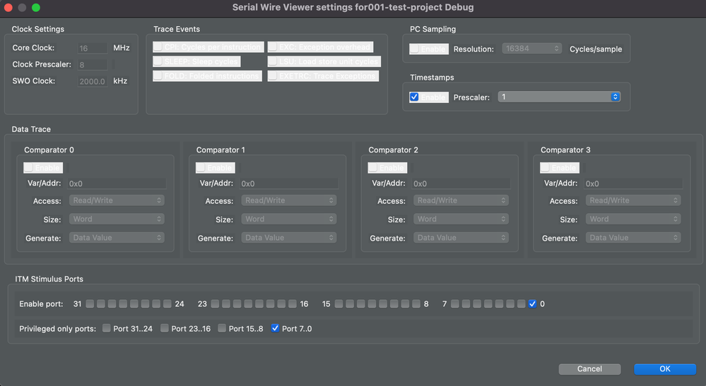

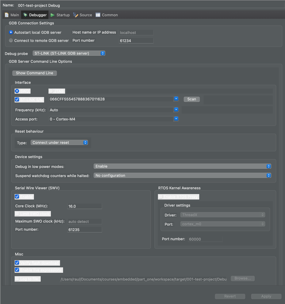

And this are the settings on Debug configuration:
And the ITM settings:

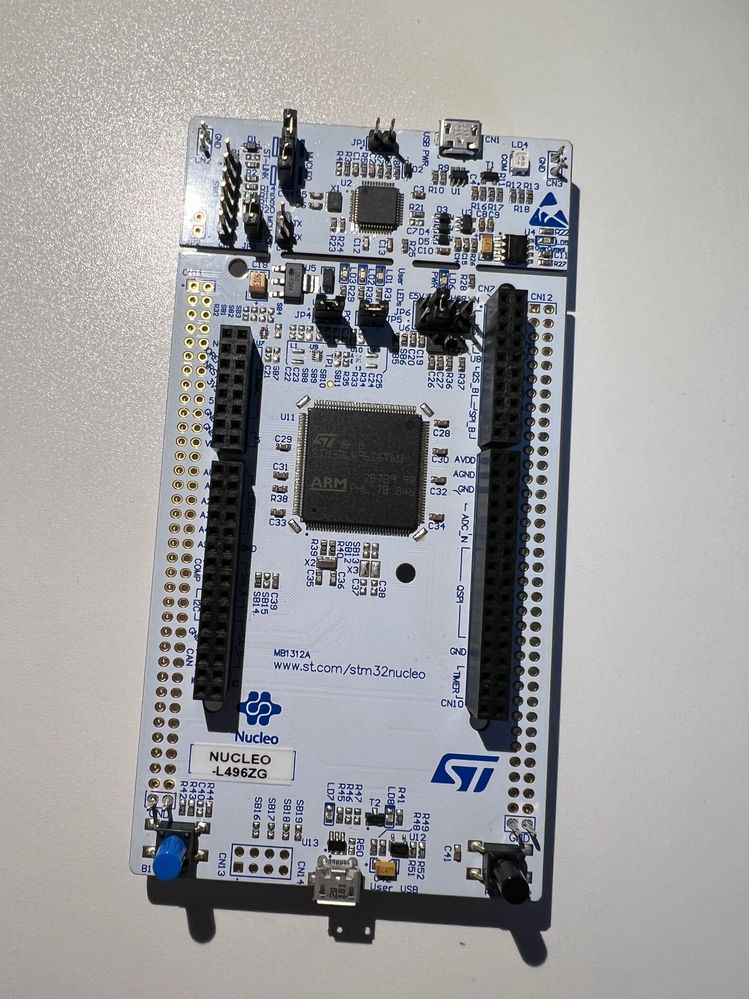

This is my board:
PB3 is connected to SWO.

And you're clocking the MCU at 16 or 80 MHz?
2022-08-19 5:11 AM
2022-08-19 5:22 AM

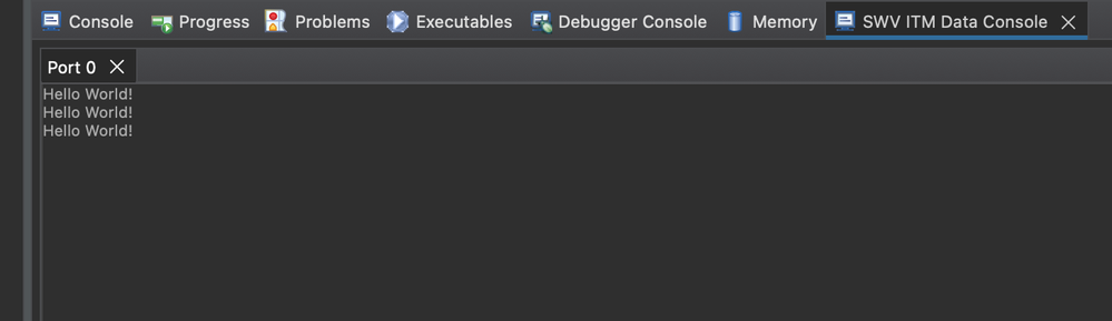

That was the issue. Thank you. Didn't set correctly the clock on IOC settings. Now is 16 MHz and it works.
Thank you very much!
