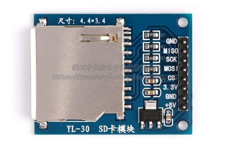

Hi�?I tried another sd card module with the same code, still failed to work.
@GChir.2​
I am looking forward to that because I tried another module, still failed.

Could you share a photo with module's connection to the board?
Have you used my code?
There's perhaps something more fundamentally wrong with your implementation or wiring.
The level translators on the prior board will likely become an issue as the bandwidth increases.
With the SDIO/SDMMC implementation I was using uniform wires of around 3"(8 cm), and those were capable of getting me to 25 MHz.
I wouldn't recommend DuPont wires which people seem to use prolifically, but rather something that really bites into the corners of the headers, like Schmartboard jumper wires, or wire-wrap.
https://schmartboard.com/jumper-wires/
Watch the CS to CLK edges, and perhaps back-off on the slew-rates.
