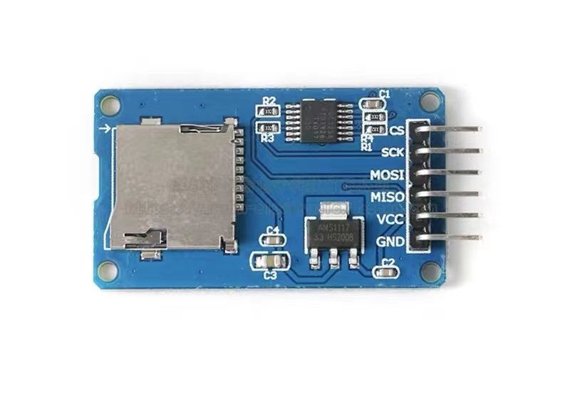

XZhen.2
Associate II
@GChir.2​
That's a 5V adapter with a level shifter. At the 3.3V of the STM32 you should perhaps consider a more direct connection.
https://www.waveshare.com/micro-sd-storage-board.htm
ok, ordered one just now. I will try again.
thanks!
