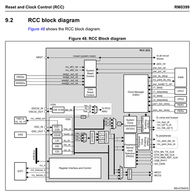

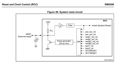

All watchdogs generate a system reset which resets both cores and most peripherals by pulling NRST low.
There is no watchdog that will only reset CM4. However, you could handle the EWI to do something similar.

2025-01-24 1:39 PM
