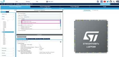

Hello @Akhilesh30,
Could you further detail the issue?
Using STM32CubeMX, and selecting STM32H743BIT6 as MCU, you can configure channels with input capture mode as following:
