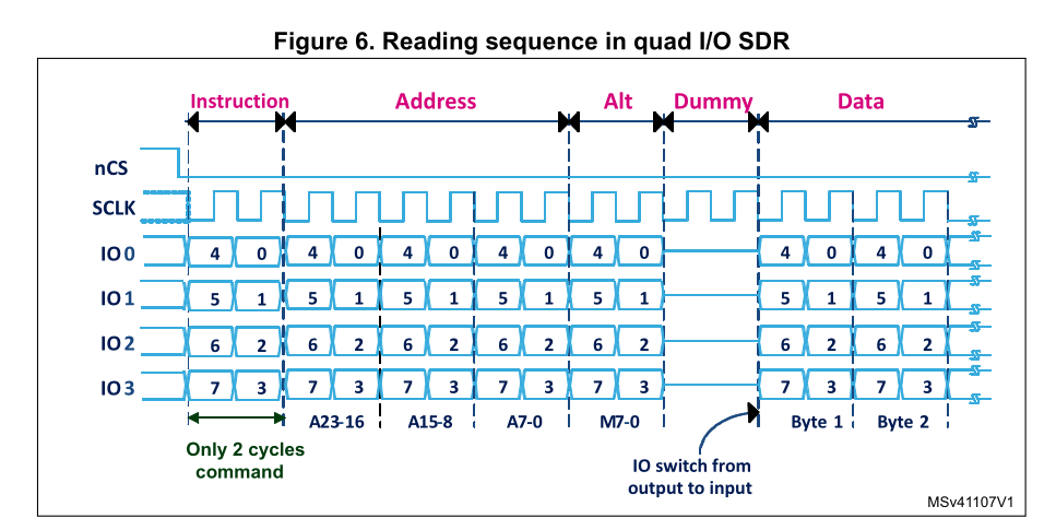

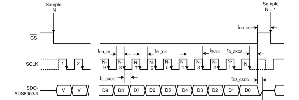

Make dual data line SPI running on nucleo-H743zi2, using SPI-2 as  master and SPI-3 slave.
1 ACCEPTED SOLUTION
Accepted Solutions
After brief review of AN4760, I get an impression that QuadSPI was specificaly designed to interface Flash memory IC.
 ADC has absolutely different requirements in respect to timing on CS line, clock - 32 SCLK clocks with 16 data bits.
See pictures:

Why no QSPI ?
See pictures:
