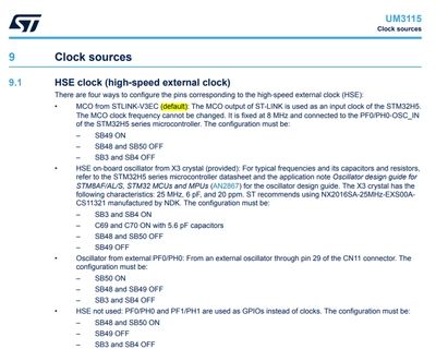

Hello @Samboozled,
Please check the clock configuration. If the external (HSE) clock is selected, verify that it is present on PH0-OSC_IN and PH1-OSC_OUT pins.

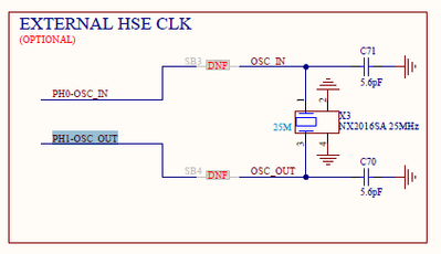

On MB1404 (NUCLEO-H563ZI) boards, HSE crystal is present but disconnected by default:
If that's your issue you can:
Hope that will help you,
best regards,
Melchior
2024-06-12 5:15 AM
to complete my answer: the user manual precise the default configuration :
So the CUBEMX template project for the NUCLEO-H563ZI configures the clock source to HSE Bypass, which is provided by the ST-LINK.
