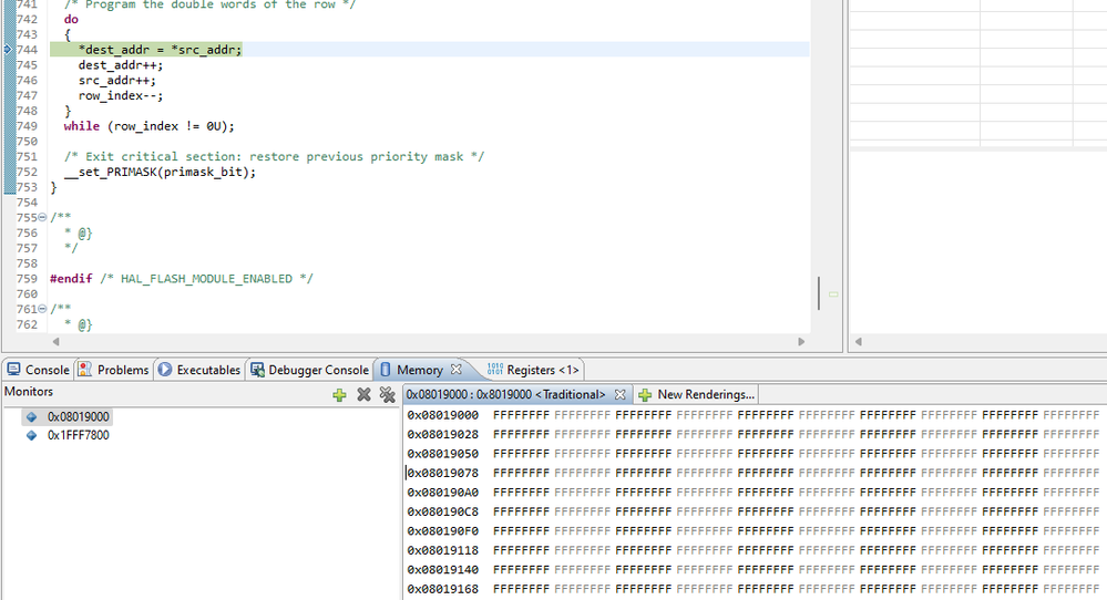

Even if the destination address in FLASH seems all erased however with the debugger I'm noticing that the highlighted piece of code is not transferring data from the origin address to flash. Here is a screen of the segment of code and flash that I'm trying to write to.

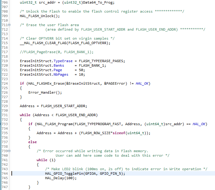

This is the structure of my flash management function, it is basically copy-pasted from the example provided by ST.
So all the proper bits are set and managed by HAL libraries. This is perfectly identical (even the data to copy) to the ST example but is not writing anything while running the example itself works fine. I can't understand what is going on since they are identical...
