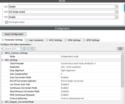

So, now I've closed SB14 and started a new project, adc + dma only.

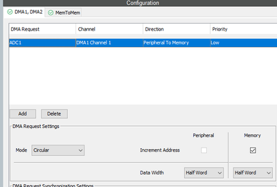

DMA Config:
With buffer for DMA data:
uint16_t adc_values[2] = {0};
And DMA start:
if (HAL_ADC_Start_DMA(&hadc1, (uint32_t *) adc_values, 2) != HAL_OK)
Error_Handler();

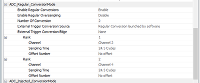

ADC config:
ADC config 2nd:

Result:
I think the point with SB14 was the solution...
Now it fine and all the values are correct.
Thank you very much!
2024-10-12 10:22 AM
The ADC is 12 bit resolution, so using uint16_t is logical. I believe ST knows this and defaults it it to Half Word automatically. Whereas if you used DMA on UART, ST defaults it to Byte.
I assumed you used the default Half Word (i should have asked), so uint16_t is what works.
